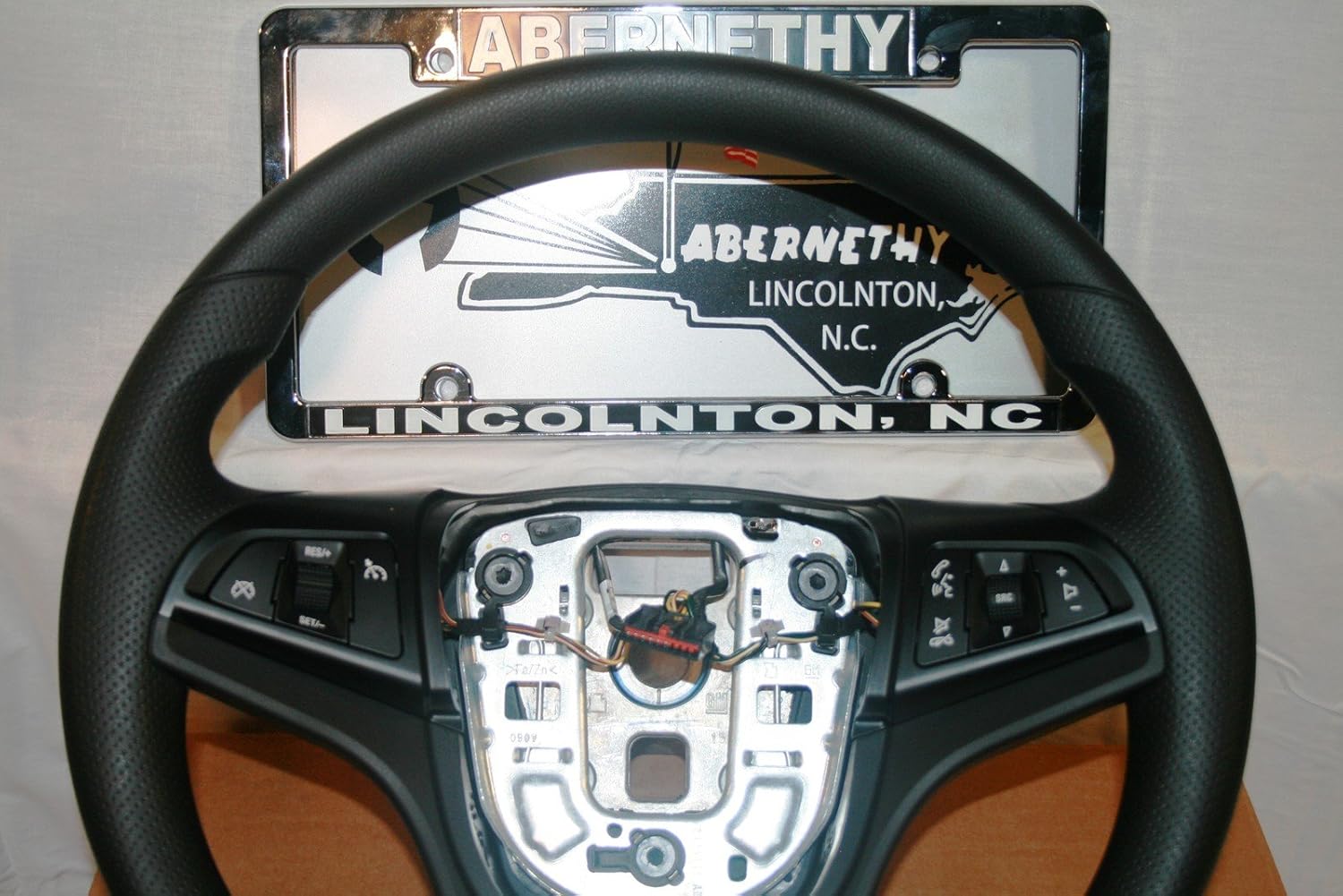

Chưa có cụ nào nhảy hố vôi hết nhỉ, em vào Os mà cũng chưa tìm ra thông tin, chỉ thấy hỏi thôi. Vấn đề là Part là có sẵn, giá khá rẻ:
Cụ Vịt với cụ San nghiên cứu vụ này xem!

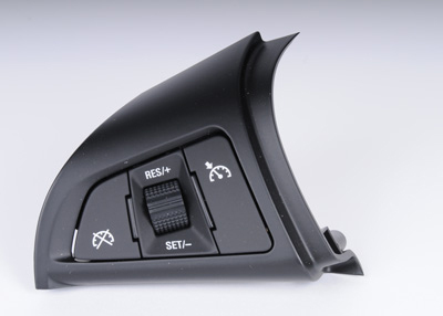

Tụi nó còn nói thế này nữa chứ:
Product Description
Title: CHEVROLET CRUZE Steering Wheel Cruise Control Switch Switches Left
Condition: Fresh new in the box. Purchase directly from manufacturer.
Packing List: 1 pcs Brand New
Color: Black
Feature: Direct Fit, Easy Installation, High Quality.
Tips: Please see compatibility chart. Identical in appearance and operation to your OEM (original equipment manufacturer) item.

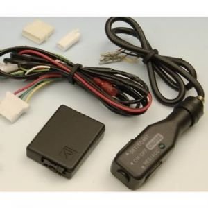

Hàng Rostra nhìn vào thế này (ảnh em lấy trên Cruzetalk):
Rob Tran
OF-129377
3/2/12
2,634
397,780 Mã lực
Điên mà nói ra
Rob Tran
OF-129377
3/2/12
2,634
397,780 Mã lực
Điên mà nói ra
Nguồn: http://www.cruzetalk.com/forum/137-audio-electrical/2714-how-self-install-aftermarket-cruise-control.html

Có người bắt ở chổ này:
Rob Tran
OF-129377
3/2/12
2,634
397,780 Mã lực
Điên mà nói ra
Nhưng em vẫn lăn tăn, có người hỏi:
I just bought a 2012 Cruze yesterday and it doesn't have cruise control. I have a couple question that may be stupid but I need help.
1) Would this 2010-2011 steering wheel work in the new 2012?
2) When you get the steering wheel that has cruise control built in the wheel is that all you need to install it cruise control to the vehicle? Like you don't need to purchase anything else?
3) When you install cruise control aftermarket or the new wheel one, will that mess up the warranty?
Thank you to anyone who answers these question. I don't know much about cars, car parts and accessories. Thanks again."
Và trả lời:
You were correct with the Flashing of the computer. You need to get the dealer or in your case another dealer to plug into the car and activate the cruise control. Bought my wife a Mazda 3 last year and had the EXACT same thing happen to me ass dealer installed that BS cruise in a BRAND NEW CAR!! I wanted to kill the guy! then he looked at me like was a jerk for calling him out on it. From what I have been able to gather on the net you need to tell the car it has the option in order for it to work. This is most likely the toughest task of all as they(the manufactures) have drilled it into the heads of the drones that this can't be done. Well that's BS IT CAN BE DONE! Another thing to look at is the brake switch. Sometimes there is a separate one for the cruise option to work.Good luck man I am trying the same thing. Oh and my dealer would remove it but not fix the hole in the trim A$$HOLE! I will not and do not go to that dealership EVER again even for air in my tires."
và:
#1 Most likely yes, the steering wheel will work, the cruise control however will not.
#2 It appears that GM has locked out cruise control on the car if it didn't come with it from the factory.
#3 No, adding an aftermarket CC won't void your warranty according to my dealership.
I'm currently in the planning phase of using the stock CC controls to control an aftermarket system to do this very thing but I still have some work to do and verify before I implement it. If I am successful I'll post a how to."
Xin lỗi các cụ, em cóp nguyên văn, sợ tiếng Anh mình kém, dịch ra tầm bậy!
